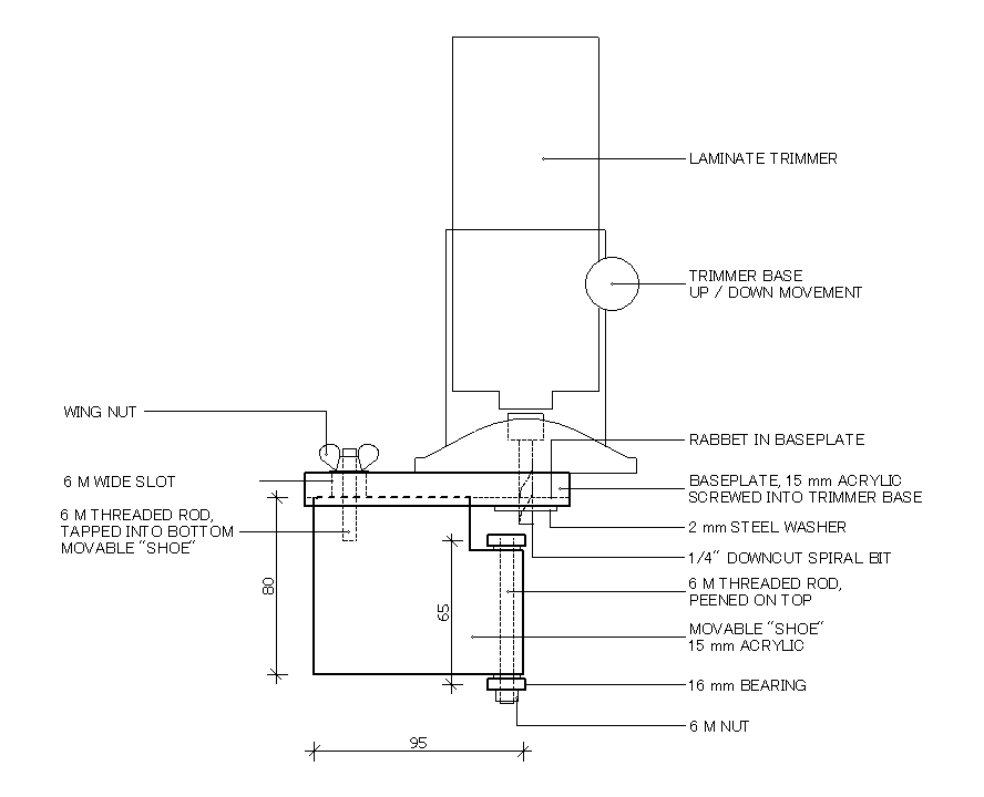

I have gotten a few requests for plans and dimensions for my binding jig, so I finally got around to it. I only operate in the metric system, sorry! To calculate the dimensions in inches, just remember that 1" = 25,4 mm.
I made mine with materials I had on hand, and that was some cheap bearings, threaded rod and some 15 mm acrylic scraps. Some people have commented that acrylic is difficult, even scary to shape and that a polycarbonate like Lexan is better for a jig like this. I don't find acrylic that hard to shape, but it can chip if you are not careful, so wear goggles! Of course, you can also use plywood, aluminum or whatever, and you will have to adjust it to your trimmer and your needs. I use a 400W Hitachi trimmer.
Here is a quick and dirty elevation (I can e-mail the .pln or .dwg or .dxf to anyone interested).
Here is how I operate the jig:
The binding rabbet width is adjusted by moving the bottom part (movable "shoe") in or out in a rabbet in the top part (base plate). A wing nut and a screw that is tapped into the movable bottom part secure it to the fixed upper part. The binding rabbet height is adjusted on the trimmer base adjustment screw. I use 1/4" carbide down cut bits (from LMI) with this jig, so the cut is very clean. The bit protrudes through a washer glued to the base which makes sure you only register on the edge of the top or back plate, meaning the plate’s radius will not interfere with the cut. I clamp this jig in a vise and rotate the guitar.
If you are clever you can probably also build a micro adjuster of some sort for the width adjustment. I just loosen the wing nut and tap lightly and test on scrap, no biggie.

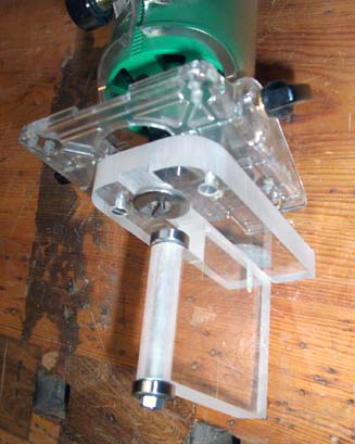

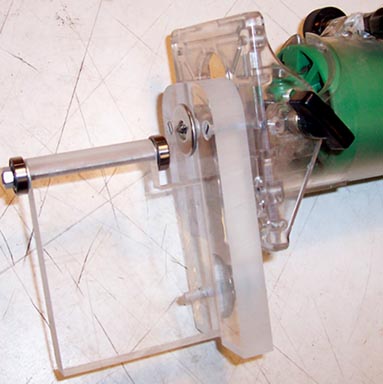

Here are a couple of snap shots again:
Front:
Side:

Serge, if I understand your question correctly, you are asking if 2 mm thick washer gives enough clearance between the bottom of base plate of the jig and the domed guitar back so this part will not to interfere with the cut. I use a 15' back, and I have not had that problem. The jig registers off the sides and a very small area close to the edge of the back plate, the taper of the back relative to the sides does not come into the equation. If you use an extreme arch, like an archtop without a recurve or something, the size of the contact area on the back might be a problem. In that case I would use a smaller OD washer, perhaps stack up a couple. If you look at the drawing, you will see the base plate is very short towards the side that overhangs the guitar back (or top), this was the reason for that design decision. If you keep the contact points firmly to the guitar you should not have a problem.

Thanks for your explanations Arnt, i was wondering and probably assuming that the washer might come in contact with the edges if i was to use your jig for free hand routing but as you mention, if the bearings are well registered to the side, only the bit will touch the wood so everything should be fine for me as long as i take the time to well position the jig and go slow right?

Serge, the washer IS a contact point, it is the ONLY contact point on the top or back of the instrument! That is it's purpose; it contacts the edge of the back or top plate and lifts the rest of the jig off the instrument so the arch of the plate will change the angle of the cut.
So there are 3 contact points in total: One on the top / back (washer), two on the side (bearings).

I made a similar jig some time back , and like Pat find it easier to use it hand held and move around the guitar.
I have found with such a small "donut" , it can easily be tipped sideways a little,and thereby alter the depth.
When it is going, it is difficult to feel the donut touching ,or seating level (both sides of the donut on the top or back) I have made my donut a little bigger to help this , which of course ,varies the depth of cut,but only marginally.
Have you had any issue in this regard ?
B.T.W. , I find the jig very succesful , but am careful about keeping both sides of the donut in contact
The other issue relates to routing the back mainly. Because guitars have a wedge shape (say 4" at the end graft and 3" at the heel ), when the jig's donut sits flush on the back , it is slightly tipped. This is no problem in itself , but as it moves around to say the waist area . the two guide side bearings don't contact the side in a 90 degree manner. Depending on which direction you are routing , either the top or bottom guide bearing contacts the upcoming curve before the other. and thereby ,tips the jig off correct angle making the width of cut narrower or thicker ( depending on which direction you are routing).
To combat this , I have put a tiny shim on one side of the donut, so that the jig sits square to the sides curvature. The thickness of the shim would depend on how much of a wedge the guitar has .
I hope I have made myself clear here.Difficult for a Kiwi
Your comments and experience are welcome thanks Arnt
Regards , KiwiCraig

              I have made my "donut" about two inches wide . This way I can feel the donut seated both sides and it's not so easily tilted sidesways . The wider the "donut" , the more depth variation . Mine is a slight compromise and the depth variation is very slight (about .5m.m. at the waist) It's not noticeable.
I first built mine after reading the Jim Williams book where he has a plan of his version , although his has a wide footprint. I also tapered the front of the donut to allow for the plate's arch.

Hi Craig, the jig can be a bit hard to balance if you use it hand held, as it is a bit top heavy. The bigger donut might help a bit, but as you say, the bigger the contact area is the more the cut will be influenced by the geometry of top or back plates. This is the reason I like to clamp the jig and move the guitar; I feel it is easier to hold the guitar straight than the trimmer + jig, and the small contact area between the steel washer and the guitar is not a problem when you use it this way.
